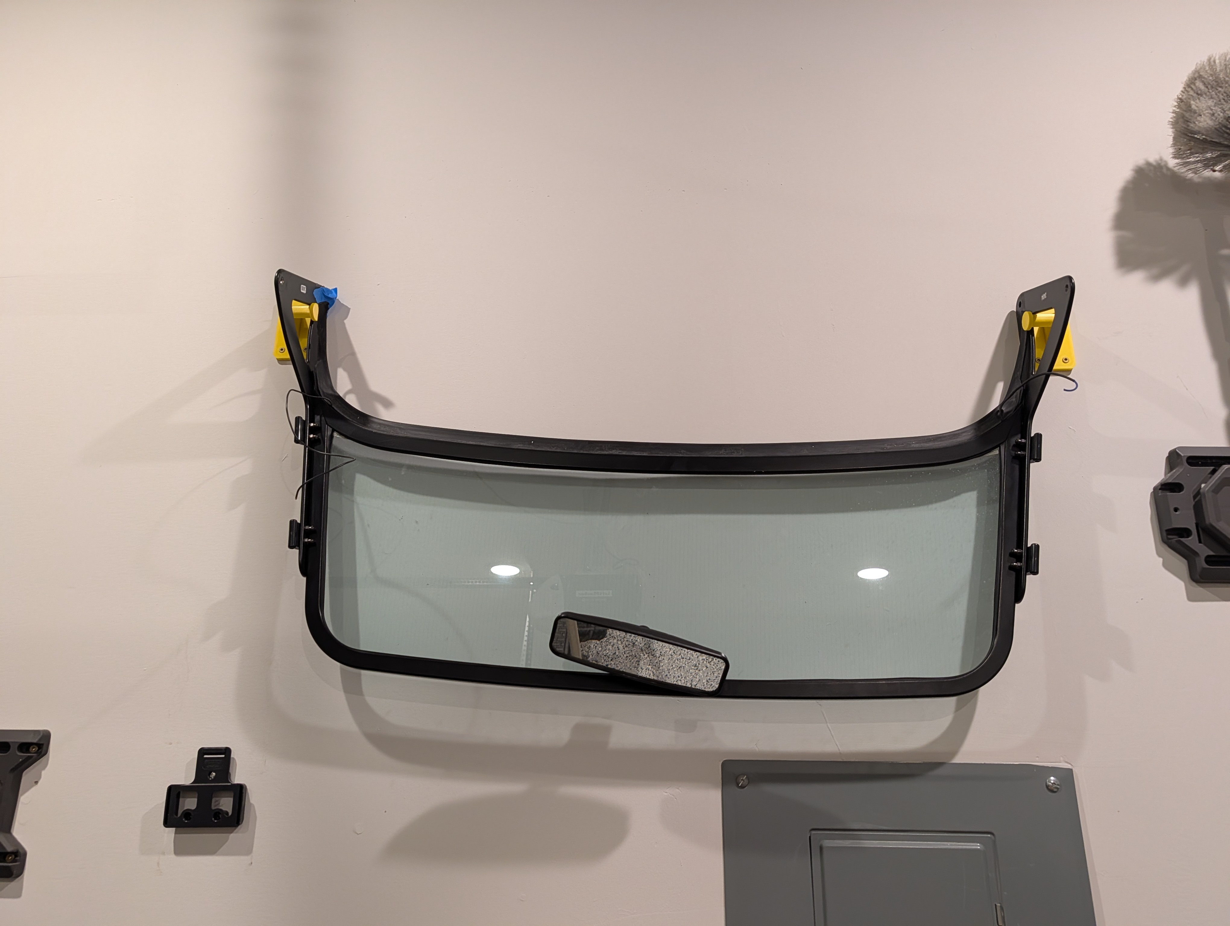

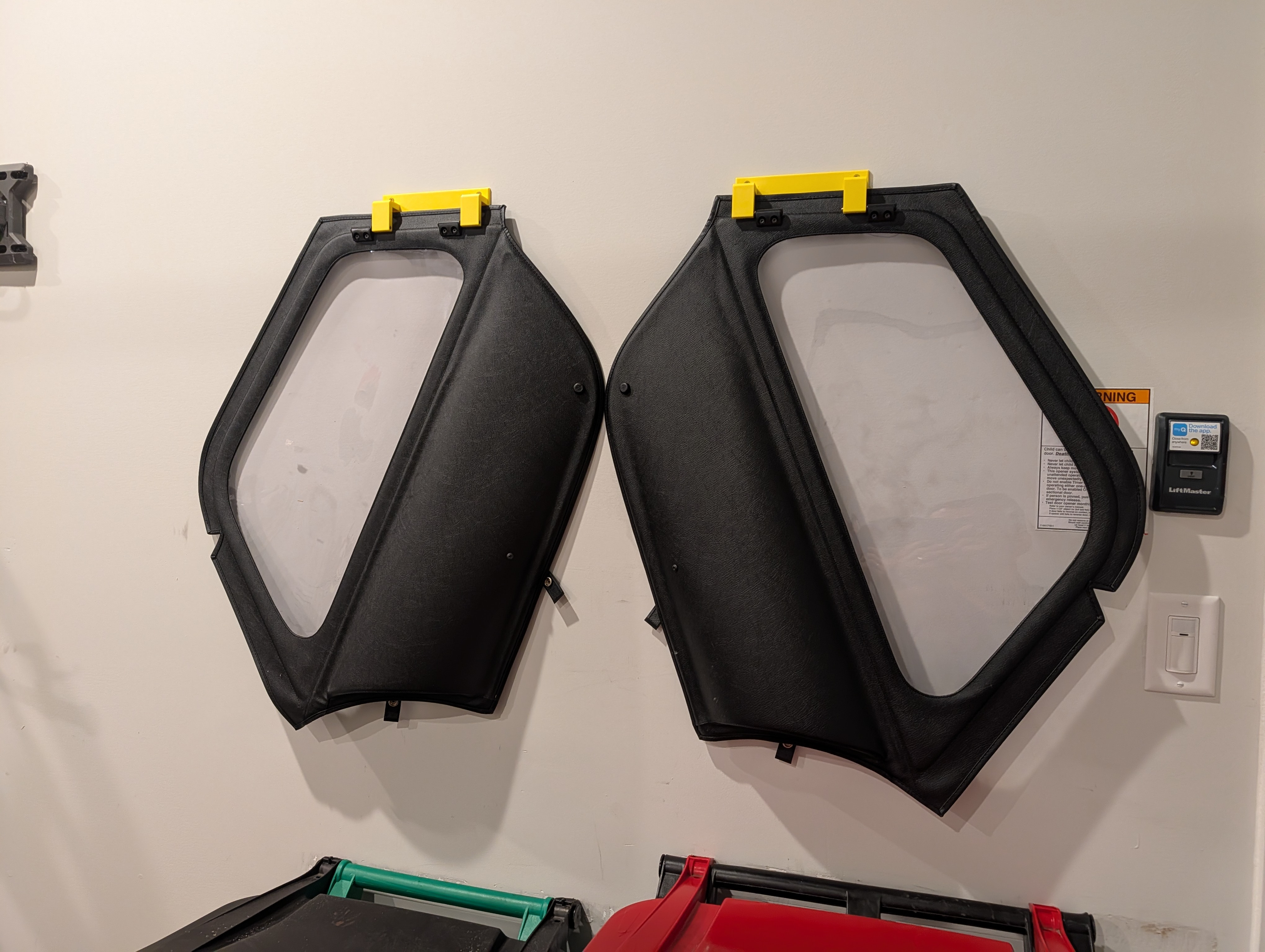

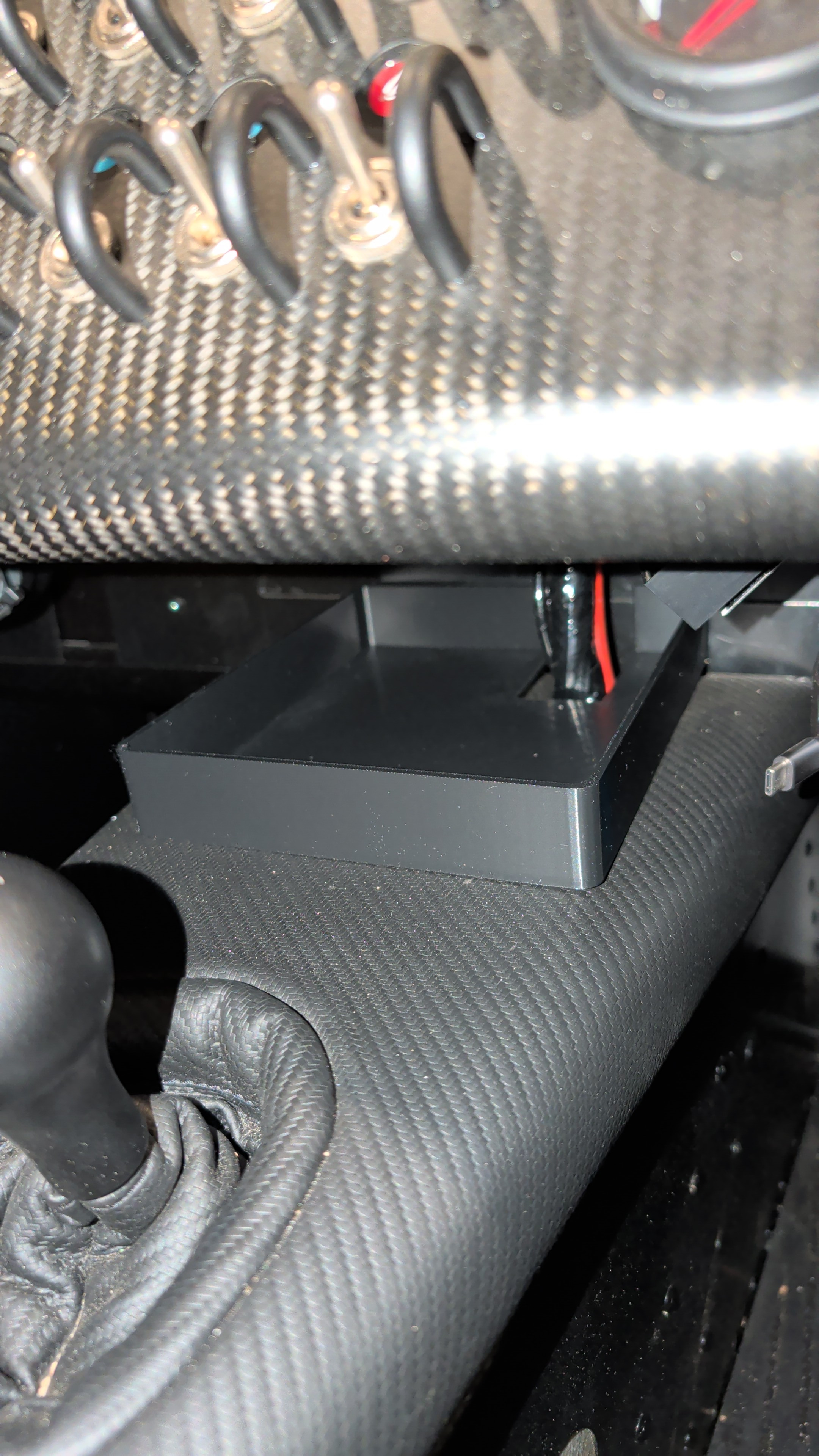

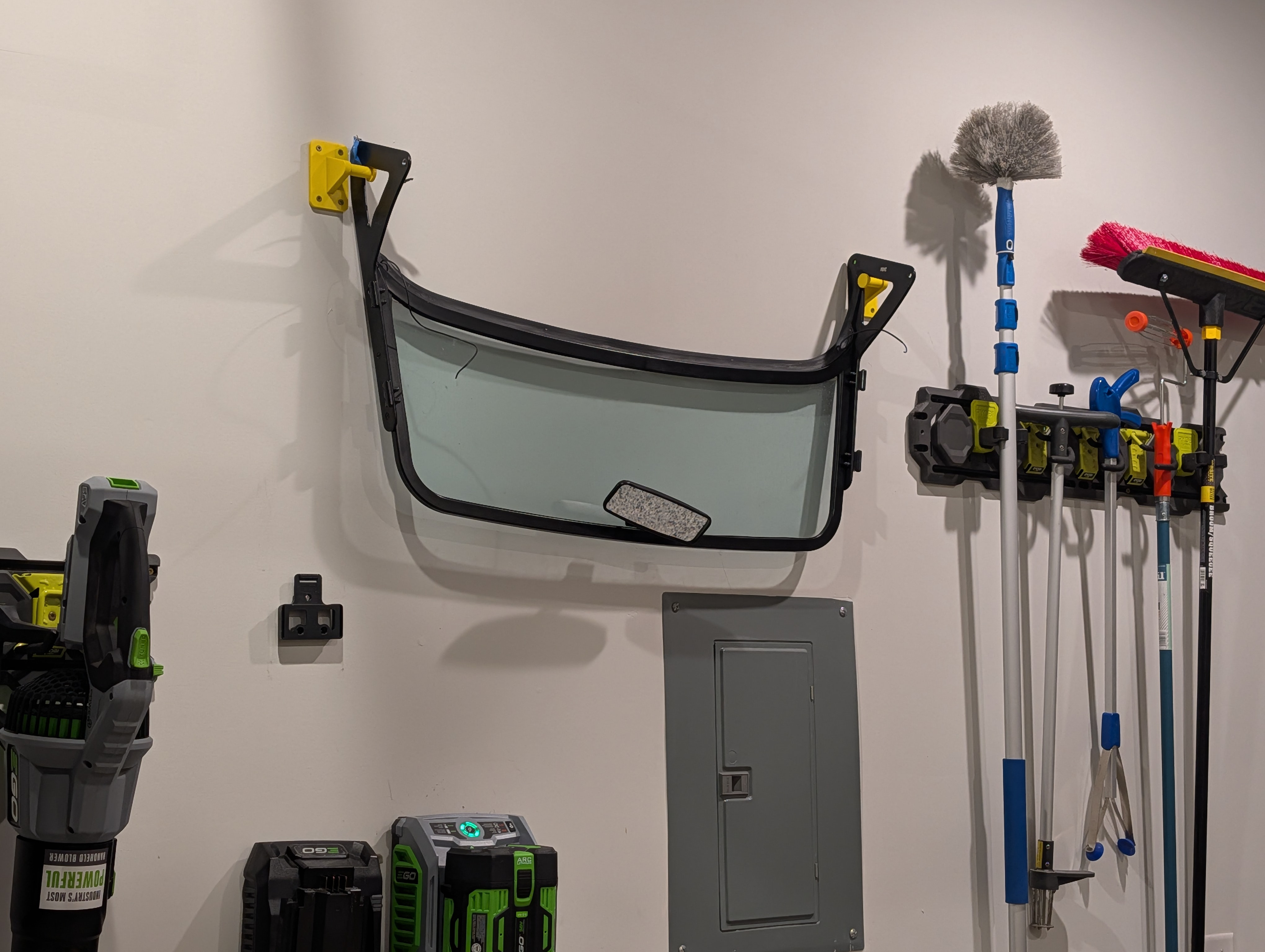

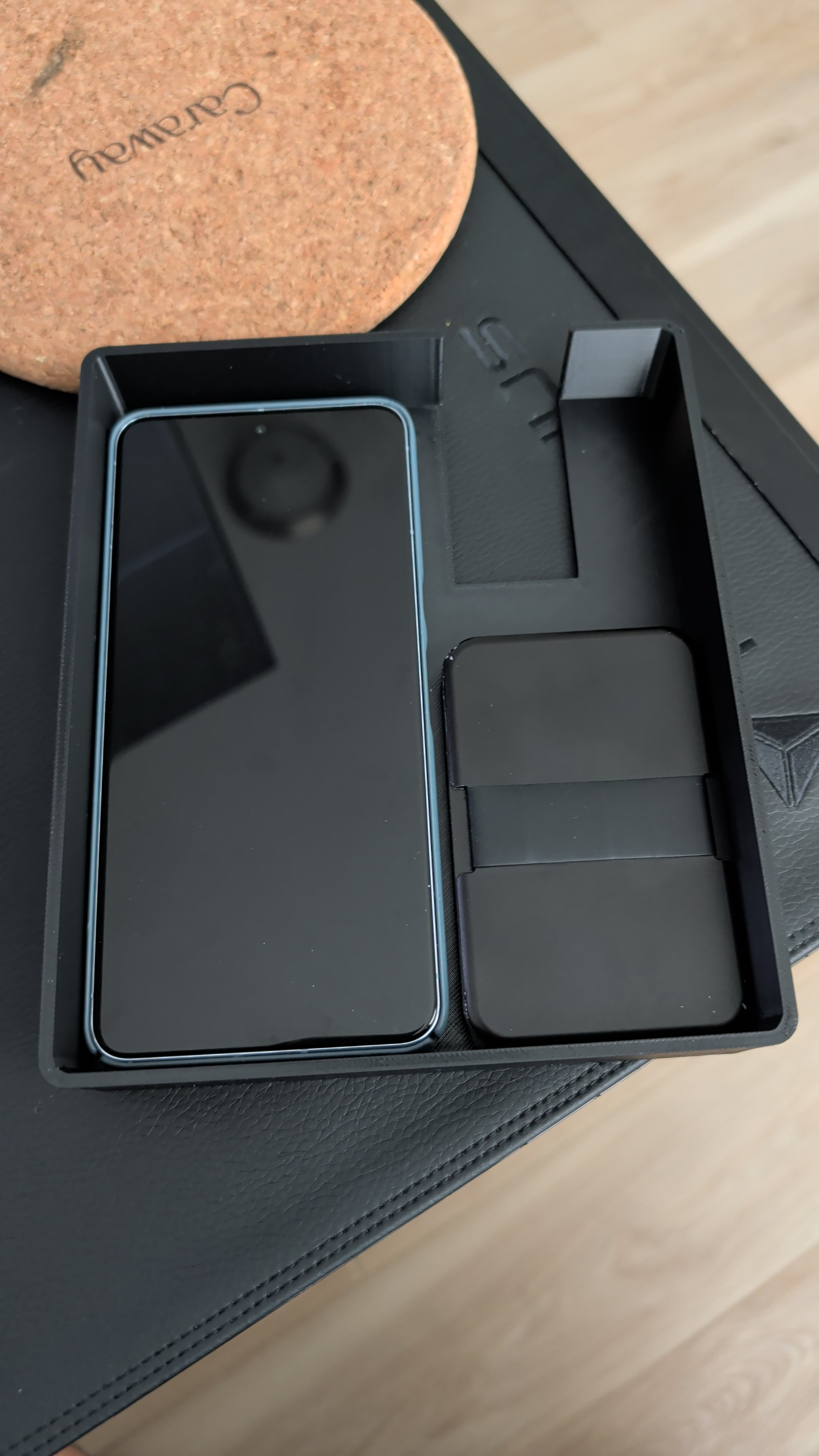

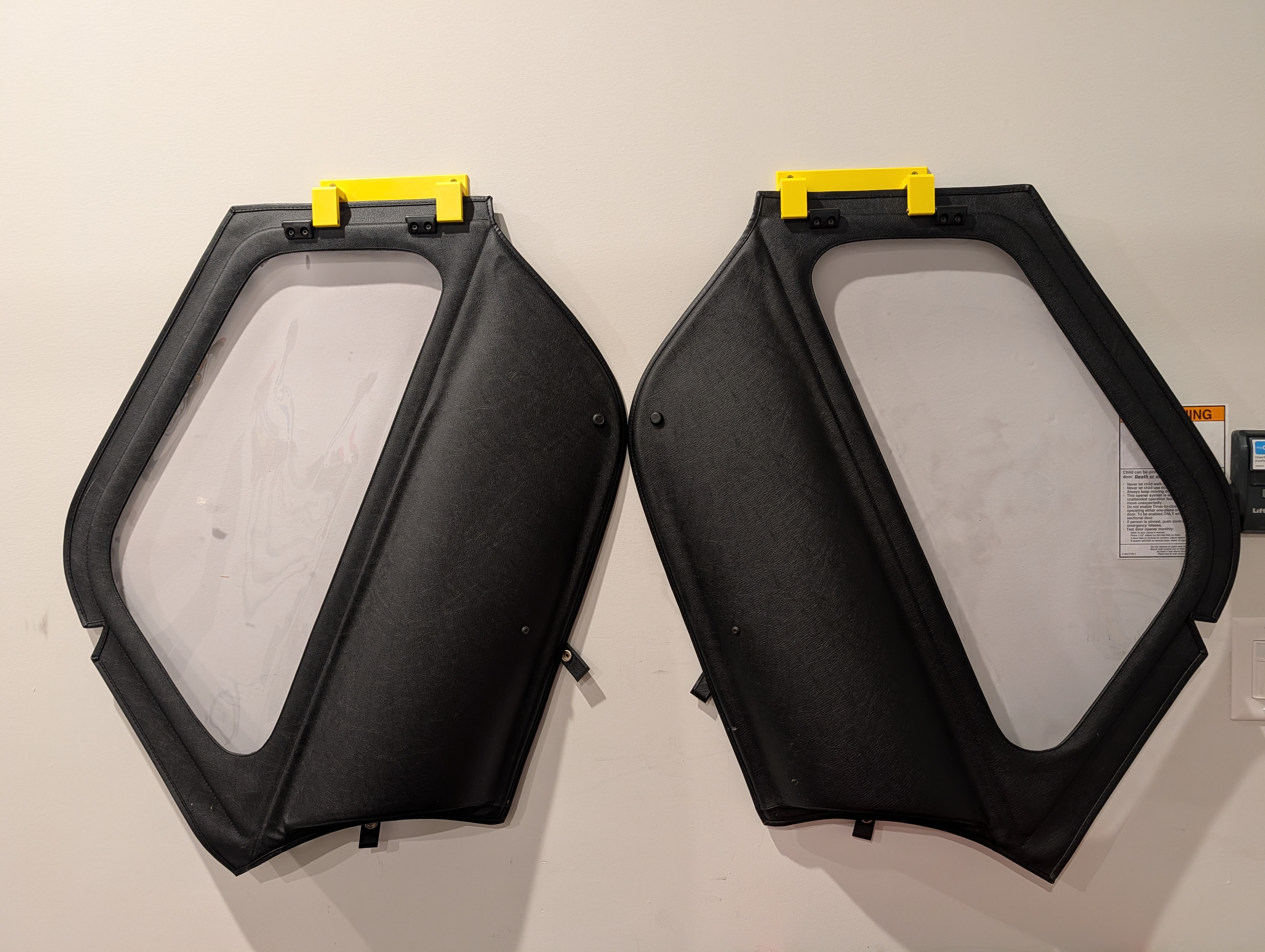

hahuang65 Posted July 8 Posted July 8 I've started printing a bunch of parts for the Caterham, particularly useful is this cheapo tray. It mounts directly against the firewall using 3M double sided DualLock, similar to how the fusebox cover is mounted. It perfectly holds my phone and wallet and has a cutout for the wiring harness. I've also got a wall mounted door hanger and a wall mounted windshield hanger designed (but not yet mounted). It's not clear from the render for the windshield hanger, but you're meant to print 2 of them, mount them spaced by your windshield length and hang your windshield by the triangular cutouts on the stanchions, with the front facing the wall so it's a flush setup with minimal protrusion from the wall. If you're interested feel free to print them. They're at https://github.com/hahuang65/3d-prints 3 2

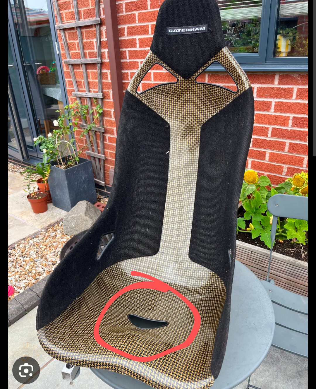

Vovchandr Posted July 8 Posted July 8 I'm still waiting for somebody to do tilett hole cup holder. These look great! 1

Vovchandr Posted July 9 Posted July 9 2 hours ago, hahuang65 said: @Vovchandr what do you mean by "tillet hole cup holder"? Maybe I'll take it on! I envision something that can use the hole as a base and be a cupholder. Over the years I've struggled to find any good spot for this mission and this seemed pretty straightforward.
Origin7 Posted July 9 Posted July 9 @Vovchandr That's a great idea. Another reason for me to get Tillet seats. I'd do this, but without the seat, it would be tough to match the geometry. I'll ask Tillet if they can send me a 3D model of this seat. It's probably a long shot.

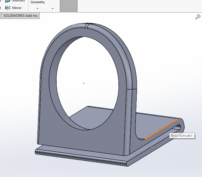

Origin7 Posted July 9 Posted July 9 @hahuang65 Nice work! This area is ripe with possibilities. I just did a gauge holder for my AFR gauge. I am not sure about the newer 7s, but on the older ones, you can hook underneath the tunnel cover to hold things securely without fasteners. 1

hahuang65 Posted July 9 Author Posted July 9 14 hours ago, Vovchandr said: use the hole as a base I have the composite Tillet seats... and the holes are a trapezoid rather than a triangle. It's still a good idea that I may pursue for myself, but I'm afraid I can't really test-fit one for a triangular shaped hole.
